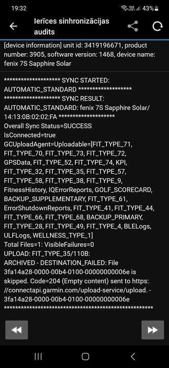

  • I have exactly the same problem with Samsung S22 phone and samsung tablet. It started today aprrox after 12am. Sone times I manage to open app without crashing, but app does not sync latest activities and crashing if I try to refresh or open calendar.
  • Actually seems *** problem is with syncing.  Without wifi or mobike data app do not crash.
