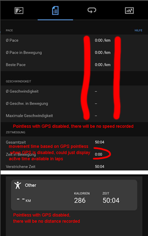

Or is it fixed with the activity profile what data is shown where? For example what's in the colored preview in the "my day" overview.

  • If I use "other" without GPS it want's to show me my distance in the preview, but without GPS there isn't a recorded distance.
    In the activity it wants to show me average speed, there isn't any.
    On the second datapage it tells me I had no pace, because there isn't any, also the 3 speed fields are empty.
    Movement time is 0 (because it did not register movement), but it could just display the active time separated from paused time, as it does on the third lap page.
    Makes no sense to display so much GPS based data if I deactivate GPS for this profile.

  • No the activity type is correct as "other" since it's not listed and I don't want to use something else for it, which it isn't.

  • I'm not walking, I'm doing something other.
