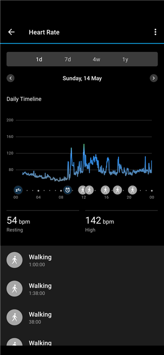

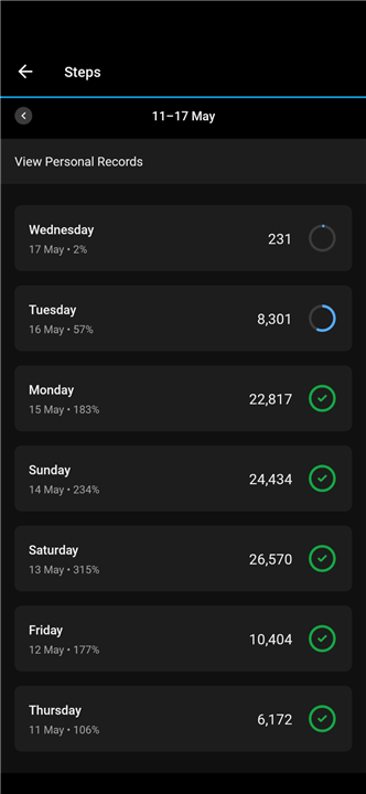

I walked approx 70,000 steps this weekend and my Instinct 2 Solar Surf didn't record any intensity minutes for it. Usually my walks are counted. Why did this happen, have Garmin changed something in the most recent update?

Was your heart rate elevated during your walks? Did you log your walks?
None of your walks are logged. Just Move IQ events. Do you usually log them or just use the Move IQ events?
Didn't you get any intensity minutes at all for those days?
What did a day when you got intensity minutes look like? Any differences compared to these days?
You do not need to log any activities to get IMs. Only the heart rate matters. Now the question is what the settings for IMs look like - using HR zones or not? And if yes, then which zones are configured, and how exactly? Also, how does the daily graph for IMs looks like for the concerned days?
Pictures attached above.
The graphs of IMs are missing, and the screenshot of your IM settings would be helpful too.
