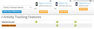

    Edge 1030 does not support the option of Intensity Minutes (and never did, AFAIK), hence it is not surprising in your case

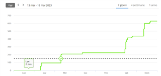

    This is what i get wearing the 645:

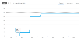

    This is now with the Fenix:
    It seems it's stopping to registering at a certain point...

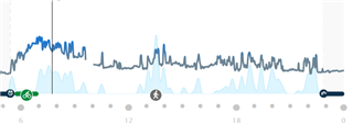

  • How does the Heart Rate graph for give day look like. And I really mean the graph from the Daily Summary, not the one from the activity! Did you use a HRM chest strap for the Edge, or did you broadcast the HR from your watch? If you used a strap, then which model?
  • I've always used an ANT+/bluetooth strap connected with the EDGE and seen by the 645, the same strap is seen by the fenix.
    I get your point...I went for example to march 18th (Saturday) and the graph registered by the 645 go up to 143bpm while the Edge has a peak of 174 and average of 147 but data seems aligned
    I did the same comparison for the activity while wearing the fenix for march 23rd (Thursday)
    The fenix has 112 bpm as peak
    The EDGE has registered 45 minutes with an average of 151, this should have pushed the intensity minutes above the 150 that week...
    Based on the other graph I've observed, the fenix always read below the edge (which may be normal if it was not connected to the same strap) but also below what the 645 was reading. I'm wearing the two watches in the same way...
