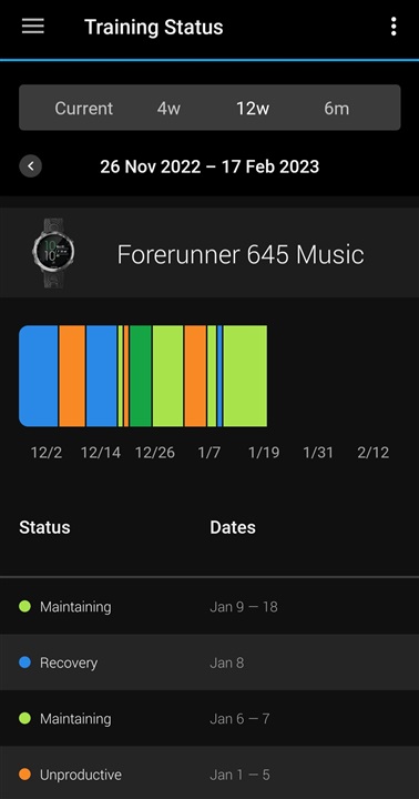

  • Thanks Andy for the tip. Unfortunately it didn't work! To give you some context, this is what I see on the screen (since 18th Jan). Not sure if it helps. Thanks again
  • Check some tips in the article Why Is My Training Status Not Updating on My Garmin Device? | Garmin Customer Support
    I recommend to pay attention especially to the section with the title "I Believe My Device Is Associated With More Than One Garmin Connect Account", and in your place I would carefully follow all the steps listed under "My Device Syncs With My Phone" and "My Device Syncs Through My Computer", and I recommend doing it even if you are absolutely sure you never used any other Garmin Connect account. The steps will not bring back the lost data, but they will assure the correct syncing of new data.
