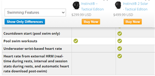

Garmin Instinct first generation does not support in-water heart rate. Only Instinct 2 does. And some other watch models of course too.
From Garmin | Compare
In the past there was a firmware version where they forgot turning off the HRM at swimming, but that's was more than a year ago. There are also some tricks to get around - for example recording the swim as running, or in some cases, the starting of the HRM widget prior the swim, may help keeping it active, but generally the quality of the HR signal in water at Instinct is not guaranteed.
