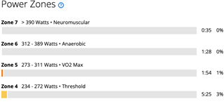

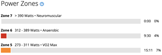

which is not correct (before, i'm not sure whem few weeks/ months ago? was ok),
I can check my 20sec max avg. from that activity, and it clearly shows the power ....
  • I just pointed out, that Garmin Connect apparently shows the value only if the time spent in given zone is greater than 1%
    How do you know that?  I gave you an example where it's not true

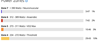

  • In case anyone else is still interested, it's not a bug. You have to check the power zones on the Garmin device.
    Zone 7 was set like this for me: 150%-150%. As a result, I didn't spend any time in Zone 7.
    Zone 7: 150%-500% on Edge 530 computer solved the problem.
  • yes, Z7 is 150-500% , and it worked before, stopped at some point. it's A BUG.
    with Edge 840 it works, and my zones are set up in the same way.

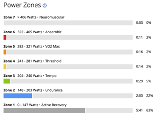

  • on my way to work, 0%, but still more than 0 seconds !  (this is with 840, and it was like this with 530 over a year ago)
  • Well, it shows the three seconds in Z7. Maybe it is less than 1% so Garmin doesn‘t show it on the graph. Shrug
  • My 20“ in Z7 during todays 1h training do not show up on my graph either. But the time I‘ve spent in that Zone does. Good enough for me.
