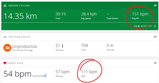

  • I've just become aware of this as well and it's incredibly disappointing. Had an Edge 530 for a few years and recently started using a Forerunner 255 for running and daily use. How is Garmin's software supposed to advise the user on fitness and training status if it's missing such critical data?
    It's bad enough having to mess about sharing data between different services, doesn't seem unreasonable to expect products from the same manufacturer to work together properly.
    Screenshot from my daily summary right now. 'Highest' HR for the day is considerably less than the average from 30 mins on the turbo.
    Appreciate the workarounds that people have suggested, but manually syncing devices all the time obviously isn't a reasonable solution. Garmin need to fix this.

  • I don't expect the devices to share data. My complaint was that the HR data from each isn't collated in Connect as might be expected. The daily summary shows a clear gap where I take the Forerunner off while cycling, even though that data is obviously recorded by the Edge.

    Concerning the all day heart rate you will need to wear the Forerunner during your ride to make it log the heart rate. The logged heart rate from the Edge will not be used for all day heart rate. The all day heart rate is also an average value of the logged heart rate so even if you wear your Forerunner during the ride you will not see the same values in the heart rate card as in the activity.
