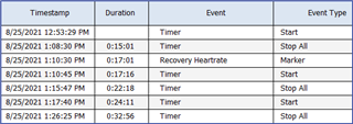

  • I'm leaning towards there being an issue with GPS acquisition.
    From the event log of the fit file you posted...
    The first timestamp that contained GPS data wasn't until  21:57 into the run, with no significant change to HR, cadence, or pace.
    I would suggest reviewing the 2 Garmin support links above. Especially regarding waiting for GPS acquisition and connecting your device to a computer and syncing with Garmin Express. Then go for a short test activity to see if it will record GPS signals at the beginning of a run. Clearing out the .fit files from the  \GARMIN\ACTIVTY folder on the watch might also help.

  • I've been experiencing the same behaviour on both watches and separate Connect apps in our family since end July this year. No activity maps are being uploaded. It started at the same time for both watches, apps, and accounts. The watch does pick up the GPS location relatively quickly and shows a green circle to confirm it's ready before we hit start. This is the same for all activies - regardless of part of a traning plan or just started individually, and it's also the same for all activity types.
    Link to picture
  • Could you post the fit file from the watch of one of these activities with no map?
  • Thanks I did check the JSON files and confirmed there were no GPS data included.
    However, after a month of frustration and nearly losing it at times, I did a full power down on my Fenix 3HR again this morning, and suddenly the maps are back. I'd be keen to hear if others see the feature return upon a full power cycle.
