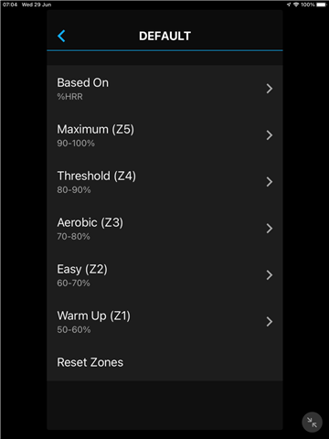

  • Just upgraded to the 955 from a Fenix 5 and having never had this problem with the old watch. HR Zones in Garmin app are set correctly but they are completely disregarded when reporting on a workout.
    above are screen grabs from the most recent workout (a run). Bizarrely, zone one is showing the highest bpm even though it still doesn’t represent anything like the parameters
  • it still doesn’t represent anything like the parameters
    Your default HR Zones are based on %HRR. What was your HR Reserve on given day? It may change every day significantly, especially if the Resting HR was not well recorded, for example because you did not wear the watch during the sleep, or during the periods of deep rest. You also need to activate the auto-detection of HR max, for it to work correctly.
    I would either use %LHTR and conduct the Guided Lactate Threshold Test (best choice), or simply use the fixed HR values (not the best way, but it will not change).
