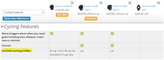

    The Forerunner 225 does not have a cycling activity profile like the newer watches or the multisport XT models.
    It also does not have the ability to add a custom profile.
