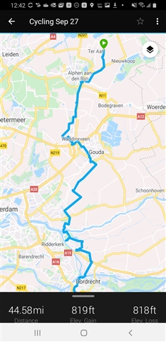

  • I'm on Garmin Connect version 4.35.1. I tested with a GPX course that I've used before. From my phone opened the file, then was prompted to choose an app
    After I chose Connect, it then opened as a course on the Connect app.

  • Unzipped your test.zip then copied it my phone, then opened it, prompted to open with Garmin Connect, selected course type road cycling. It opened as "Cycling Sept 27" I then pressed "done" to save. I made it public so you can see it here.
    https://connect.garmin.com/modern/course/43227161
