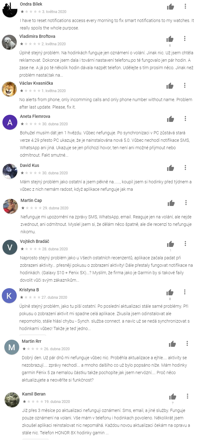

  • Former Member
    0 Former Member over 5 years ago in reply to trux
    I just count 12 comments about notification after last upgrade in last week :) So thats why I get suspicion about version trouble .. sorry Slight smile
  • I still do not see more than 3 in 150 comments. Would you dare posting the user names of the 12 you see?
  • Former Member
    I pick something for you from last 10 days.. But I dont know where are you going. Convince me that the problem I have does not exist? My question was, if somebody solve issue, what happend after update, because before I dont have any problem Slight smile
  • OK, I see, I do not use the Czech localisation, hence I get English comments only. Looks like Czechs complain more than the rest of the world (ot at least more than the anglophone part) Slight smile
    Now seriously. Most of the comments on your screenshot date from the time before the release of the current version (Apr 28th), and some of the other ones refer to older versions anyway, so it somehow invalidates your theory that it was introduced by the latest update.
