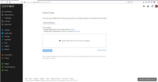

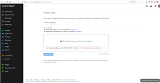

    thanks for replying,I agree with you. I'm sure my data are not erased or crashed, it's just a question of synchro but I don't know if I did the right manipulation. Here is the screen I had in my garmin connect app when I want to see my last year's activities :
    So I tried to import my old activities from a fit files I had.
    I pasted you here below the screens of each step I've made to import the fit files on garmin connect app.
    Step 1 : I had fit files from my account
    Step 2 : Importing the fit files on garmin connect
    Step 3 : message from garmin connect app but when I refresh my app, nothing changed.
