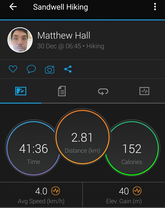

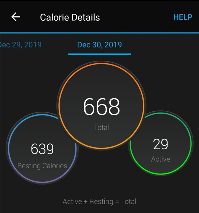

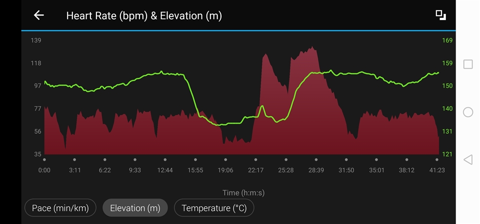

    OK, a walk around the local park with just the Fenix 5s HR Reading.
    Couple of km, a big steep hill down and back up in the middle, casual pace.
    Screenshots of HR/elevation, activity and daily calorie. This is at 7.30am, so that's why they're all so low.
  • Yes, it looks as bad as before. With 152 Cal burned during 41.5 minutes, after deducing the BMR Calories, it should give around 93 active Cal alone for the walking (plus some smaller amount for the unlogged activity that morning).
