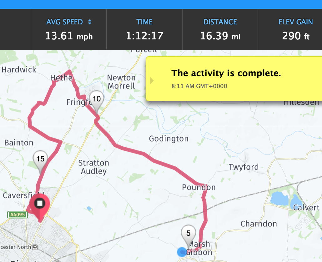

  • I did another ride yesterday OnePlus 6, Android Pie, GC 4.13.8 with Livetrack. As in my previous post, it showed where I am like it should. It doesn't show the expected route (even though riding a preset course) like it used to. The other thing to note is that if you take a break (i.e. pause the timer) it only shows the route from after the break. So if you stopped after 5 miles of a 20 mile ride it would only show the route from 5-20 and not the first 5. Seems a bit odd, but at least it IS now showing where I am when out and about, which is the most important thing. Looks like we might be getting there :) It has the total ride distance and stats correct, but only shows the route after the last 'break' (I had to stop to wipe the lens of my rearward dashcam which got splashed).ciq.forums.garmin.com/.../1448101.png
  • Did you or someone else check to see during the first miles before the break if there was a track, or did the tracking only start to work after your break? If there was a track displayed of the first part but was then later erased, this might be meant as a kind of privacy feature.
    Edit: Just now starting to wonder, what position information does LT 4.13.x use? From the Garmin device or from the phone? I always assumed the location is from the device because other data from the device (heart rate) is included in the livetrack data, but if it was changed in later versions to use the phone's location data instead, it is no wonder that it almost never works for me (my phone's GPS is not that good). BTW I am still using 4.8.
    I certainly hope it is not using the phone's GPS data, that would deplete the phone battery by using it's GPS unnecessarily. Why do that when GPS data is already known on the watch which already has to send to the phone all the rest of the parameters you mention.
    I did a quick test using my VA3 and Samsung Galaxy S7 running GCM 4.8. It is NOT using the phone GPS. The phones GPS indicator has not come on in the 5 minutes the test is running yet LT is showing my location. Maybe this is a change they made in the later versions of GCM that are having the problem, I can't tell that as I'm not willing to update my GCM until this darned bug is confirmed fixed.
