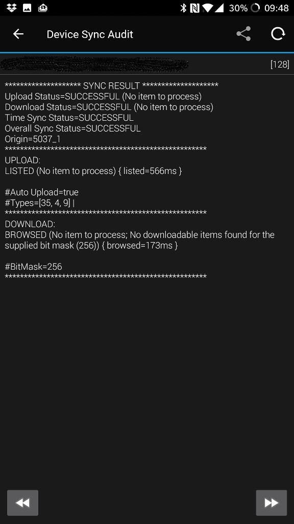

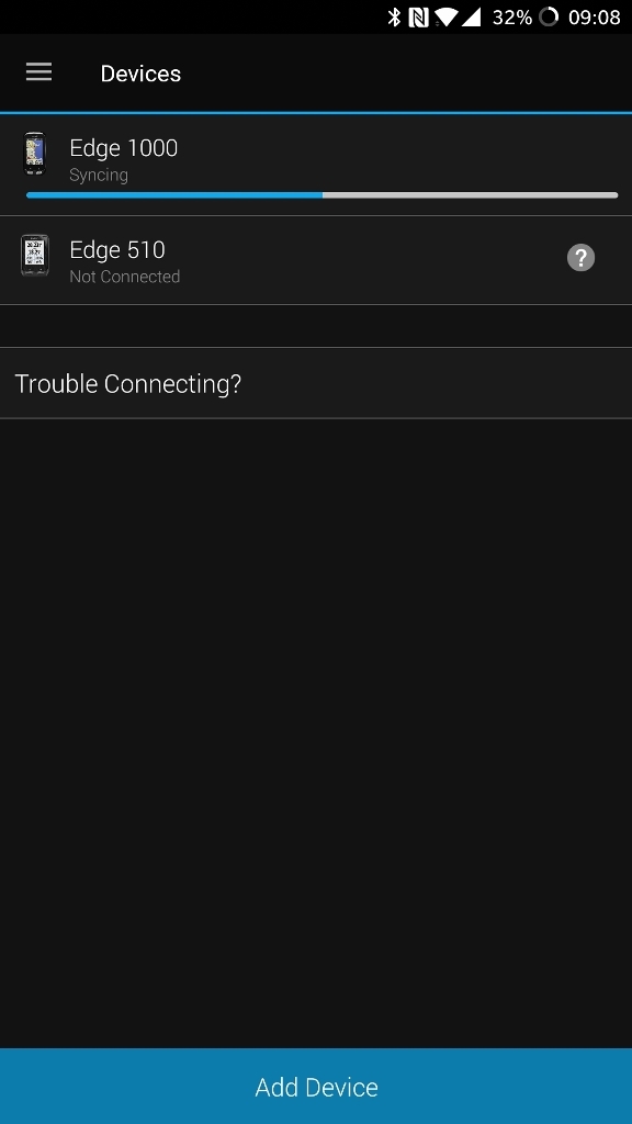

When I first turn on my Edge 1000, the sync starts and a green bar reaches 100% and completes, then after a couple of minutes it then tries to sync again. This time the blue bar moves to 50% and then gets stuck (see picture). Garmin Connect says that the Edge is connected (see picture). I've attached the last Sync Audit Reports
I've tried removing the Bluetooth pairing and re connecting.
First I thought it was the Strava Routes so I uninstalled the IQ App
Logged out of Garmin Connect and logged back in again.
So I'm not sure what is causing this or what to try next, has anyone seen this issue or is it an Edge 1000 problem?

Garmin Connect Mobile Android 4.7 ciq.forums.garmin.com/.../1356674.jpg ciq.forums.garmin.com/.../1356675.jpg ciq.forums.garmin.com/.../1356676.jpg ciq.forums.garmin.com/.../1356677.jpg
