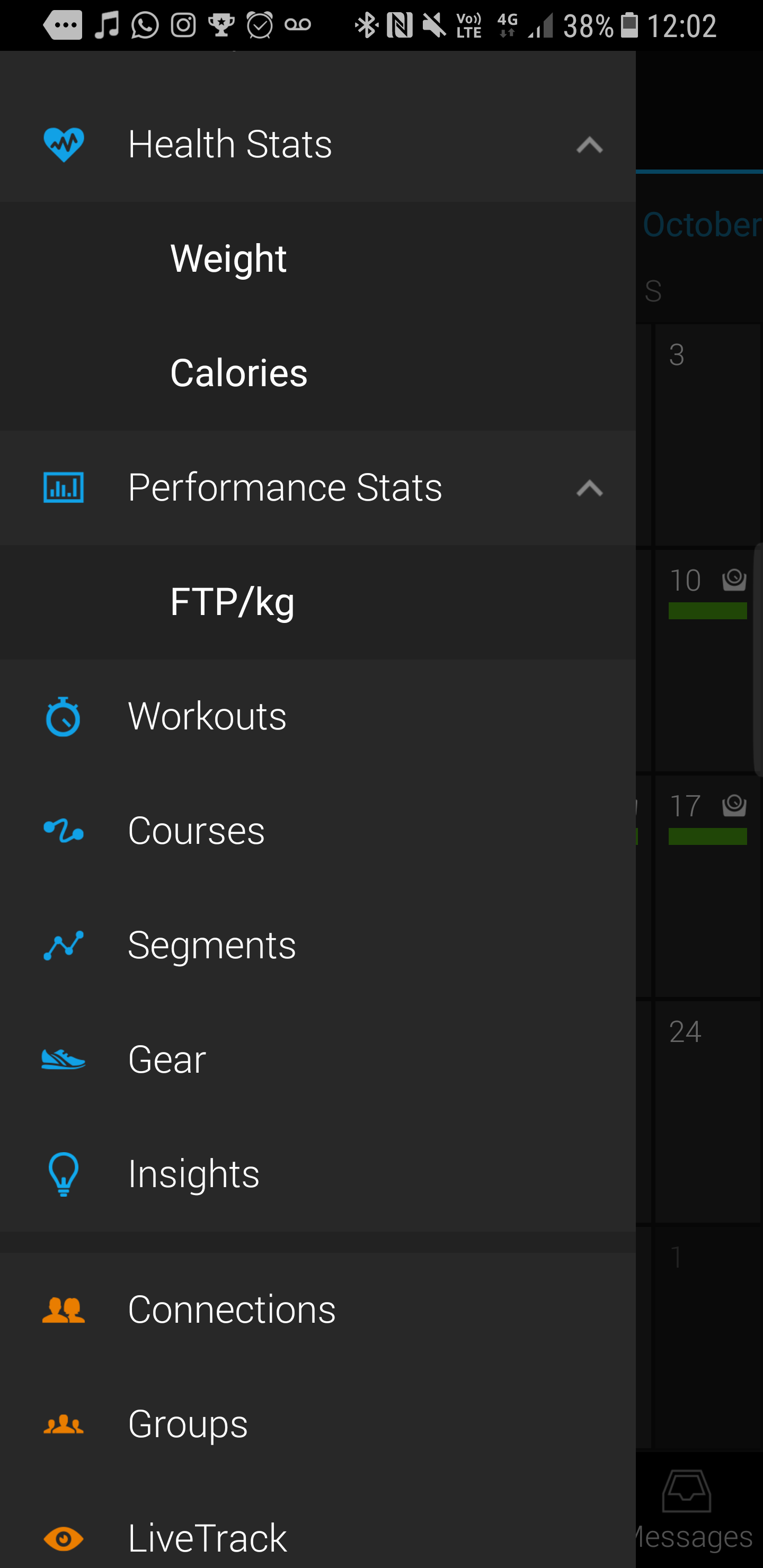

I had no response to previous forum post. Just to remind it was - " [h=2]No VO2, Stress Score and FTP[/h] 09-12-2017, 07:02 AM
I cannot see why these metrics are not sync'd to the app. On a previous iteration of GC it had Vo2 Max field within Performance stats. Now all that resides there, is a non functioning FTP.
Seems a bit silly that the app cannot pull through data from a device. In this case Edge 820.
I wonder if the app is sensitive to device, in which case, is the 820 fully supported in GC?"

So a Standard response. All of which is ticked - power meter, HRM, BT connected from 820 to GCM etc, etc.
I was convinced that in the performance stats that previous metrics were recorded in previous iterations of GCM. So I downloaded the 3.16.1 APK which was released around March/April time. Following a sync with my Edge 820, suprise suprise, HRV stress showed up. No Vo2, but I'm Sure, if I went farther into the app distance, I bet one of the previous builds would have it.

I get that GCM is basic and the webpage is probably the place to go. But I feel this simple testing of App release and ensuring our expensive devices sync and give us the metrics we desire is necessary Otherwise, not sure what the point is, other than the app being a conduit
I've seen on a previous post regarding no FTP that Garmin have acknowledged this and are working on it. But that member indicated he had No FTP and Vo2 Max. I have neither in the up to date version of the app
Please fix!
