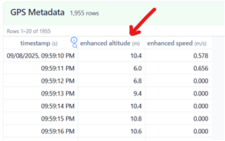

    • If you need it in the FIT file, then it is already there. If you open the activity FIT file with the https://www.fitfileviewer.com/, you find the GPS elevation data in the block "GPS Metadata"

    And as for the training file - as I explained, it contains both types of the elevation data - the barometric as well as the GPS based elevation. So if you use the activity file for some further processing, the data is there.
