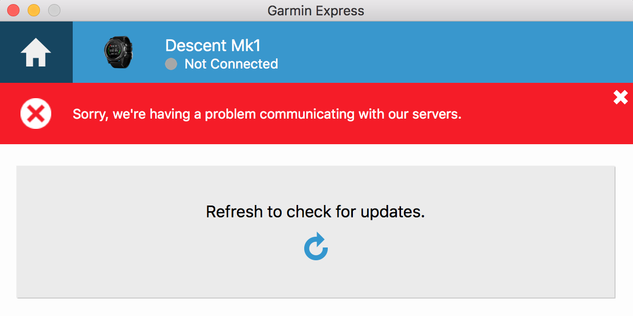

Not sure when this started, probably a couple of days ago, but from my MAC I cannot connect to the Garmin servers. It sync's and updates activities but not apps.
I am having the same problem with Express, on Mac. Version 6.7. Wont sync my Fenix 5S or update to 10.0 from 9.20. Watch is syncing normally to Connect on my smart phone via Bluetooth Just to see, I installed Express on a PC I have access to, and it fails to download on that machine as well. Fails at the download phase, just like on the Mac version. Does this both on my home network, at work, and on a mobile hotspot LTE from my iPhone. ciq.forums.garmin.com/.../1388455.png

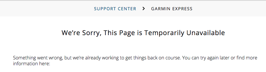

I have had exactly the same problem after updating Express to 6.7 on Mac while I had no problem when login in Connect with same credentials. Then I realised that going to 'About' window in Express and clicking any of the links (Privacy policy, for example) it got me to a non existing webpage. Weird. The reason is that these clever guys from Garmin take language ISO code from OS to create the webpage URL but then they do not support all language ISO codes. In my case my OS is configured in Catalan (ca-ES ISO code) so they are redirecting to a https:///www.garmin.com/ca-ES which does not exists. My guess is that they did the same for the login http call and I simply change OS language to spanish to have a ISO code es-ES which I knew it was supported. I was right, it worked without problem and it logged in. My advice is to change OS language to english and country in Express advanced preferences to US and it should work. Once logged in you can revert the changes. As a developer & engineer I still do not believe how this basic bug has passed Garmin QA.
I have the same problem, started about 2 weeks ago (think it coincided with express 6.7 update), I'm on beta firmware 10.52 on Fenix 5x - Mac. I tried the above suggestion and have cleaned all the caches, keychain items , added removed device multiple times with different settings. I tried on authentication domain US with system language / date time English (US) and VPN in US (auth domain was en-US) no dice.

Here is a snapshot from the logs: 2018-08-14 11.18.48 (GMT+10:00) | 775 | E | ServerRequest failed with Error:Error Domain=HttpStatusCodeErrorDomain Code=500 "(null)" UserInfo={NSErrorFailingURLKey=omt.garmin.com/.../GetPreloadedMapUpdates} 2018-08-14 11.18.48 (GMT+10:00) | 775 | E | Error getting map updates for [XXXXXXXXX]: Error Domain=HttpStatusCodeErrorDomain Code=500 "(null)" UserInfo={NSErrorFailingURLKey=omt.garmin.com/.../GetPreloadedMapUpdates} 2018-08-14 11.18.48 (GMT+10:00) | 57699 | I | Update Check Complete: [(null)] 2018-08-14 11.18.48 (GMT+10:00) | 57699 | W | AvailableUpdates: updatesForDevice [XXXXXXXX]: failed to retrieve update group 2018-08-14 11.18.48 (GMT+10:00) | 64791 | I | Could not clean map cache. Error getting available updates: Error Domain=HttpStatusCodeErrorDomain Code=500 "(null)" UserInfo={NSErrorFailingURLKey=omt.garmin.com/.../GetPreloadedMapUpdates}
I have same problem after updating to 6.7 version, I tried to completely uninstall garmin express and reinstall re-downloaded setup file. Still same error.
