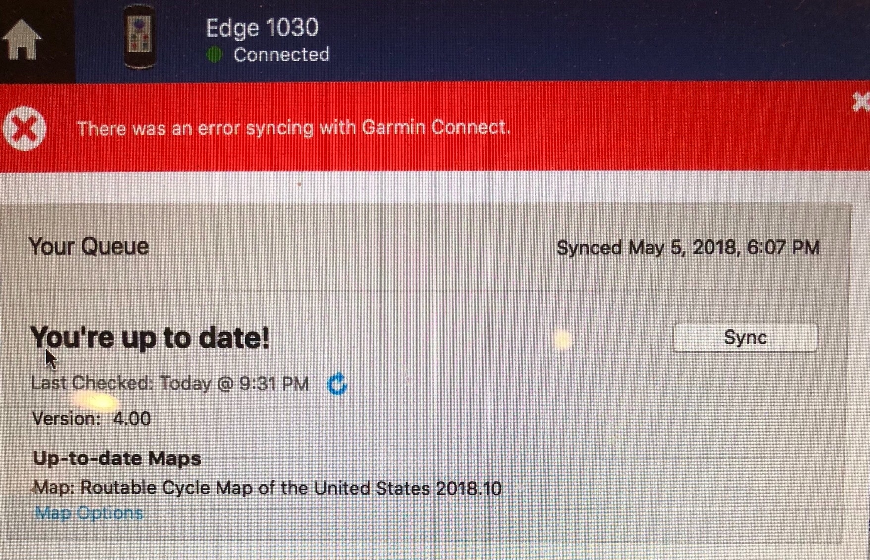

Since updating to Garmin Express v6.4.0.0 I've been unable to use Garmin Express to sync with my Edge 1030. At least that's what it's telling me (I was able to use the application to add and remove some data fields and widgets today despite it giving me an error!)
Further, today I tried to sync data with ride video and Virb Edit is telling me the device is not connected. All the while GE tells me it's there!
I attached a photo to show the confusion...the Edge shows connected, GE shows a connection and Virb says there's nothing there.
Very frustrating...

Help gratefully received! ciq.forums.garmin.com/.../1343718.jpg
