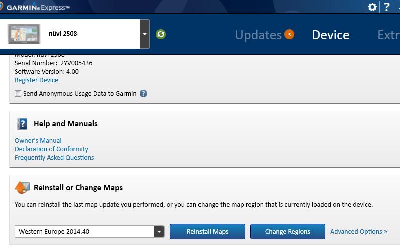

  • You're on the Install Updates tab and not, as I posted, the Device tab:
    See this screenshot
    Now click advanced options and select Download to PC

    I am on that page but there is not a "Change Regions" or "Advanced Options" only the "Reinstall Maps Button" and the maps drop down box
