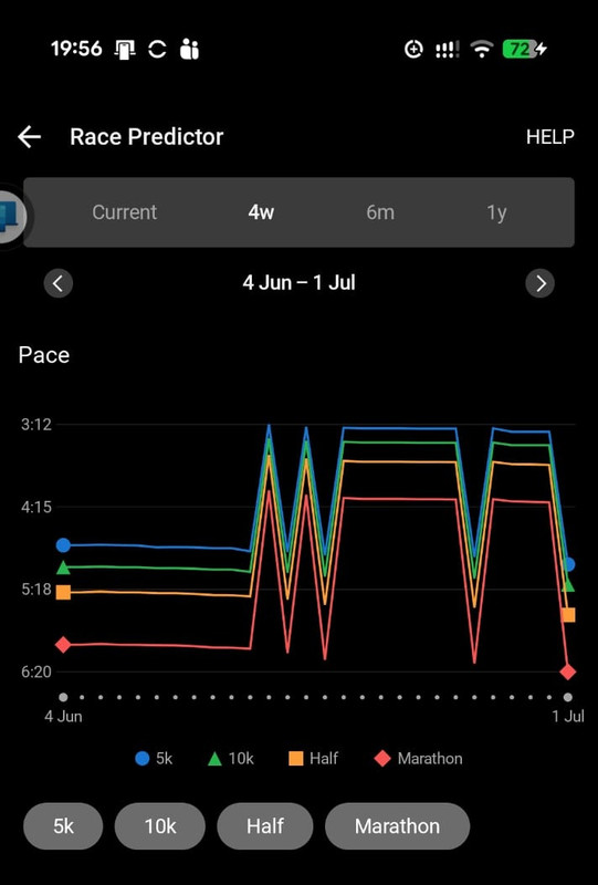

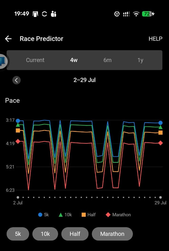

My race predictor is going crazy: since the beginning of June, it toggles my predictions from top amateur athlete (which I am not) to regular amateur althlete (which I am).
The pattern is really weird: every now and then (bit random) my prediction goes to ~3h marathon and every now and then (again random) it switches back to ~4.30h marathon.
The latter is realistic.

  • I wouldn't say it is after recording an activity. I record appr. 8 rides and 3 runs every week.
    If you take a look at the screenshots, it started somewhere in June. Since them, sometimes it's OK and sometimes not.
    Sometimes I charge my watch via PC, sometimes not.
    Considering it acts like this for many weeks, I don't think it will resolve itself.
