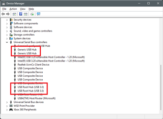

1) Go to the start menu and search for "Device Manager"
2) Scroll to the bottom of the list for "Universal Serial Bus controllers" and expand the list
3) Find the item named "USB Root Hub" or "Generic USB Hub" (there may be multiple of them)
4) right click on the "USB Root Hub" and choose properties
5) Click on the tab for "Power Management"
6) Uncheck the box for "Allow the computer to turn off this device to save power"
I couldn't tell which hub my cable was connected to so I did this setting on all 4.
