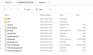

On the spoofing solution (more on it here - http://www.poi-factory.com/node/39231), please jump to point 9, about having to rename files. What I have found now is in addition to installing the gmapprom.img, gmapprom.gma and gmapprom.unl files, which normally need to be renamed, GE is also installing files gmapsupp.img, gmapsupp.gma and gmapsupp.unl. i.e. installing files that previously the user would have to create by renaming the relevant *prom.* files.
I've tried various permutations of renaming the *prom.* files and the *supp.* files that GE installed, moving the *prom.* files out of the Garmin directory on the card etc., but none of this works. When the SD card is put back in the zumo after using the spoofing method, only the base maps are shown.

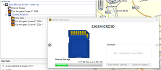

    I've opened Base Camp without the zumo attached and inserted the 32GB SD card into the laptop.
    In Base Camp, right clicking on the User Data folder (see screen grab) and selecting "Device Information) shows the card has 29.7GB free (which is how FAT32 formats a 32GB card)

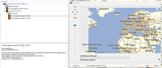

    However, if I now try to right click and select "Install Maps on Memory Card", I start with MapInstall (opened from Basecamp) only showing 4GB free (screen grab)
    Now, when I select maps, my available memory starts to count down from 4GB and as soon as I exceed 4G, MapInstall highlights that >4GB have been selected. If I click continue, get a warning message "All of your maps will not fit on your memory card (D:\). Please select fewer map regions".
    I now think that this is nothing to do with the SD card or even GE and what I am hitting is the 4GB file limit in FAT32 and a limitation in GE or Basecamp that means it cannot split files larger than 8GB (i.e. in this case, approx 9GB) into more than 2 files of less than 4GB each.
  • OK, so BaseCamp says the card has over 20Gb free. In that case right click the card, select install maps and follow the wizard. Note you must right click the card not the device.
