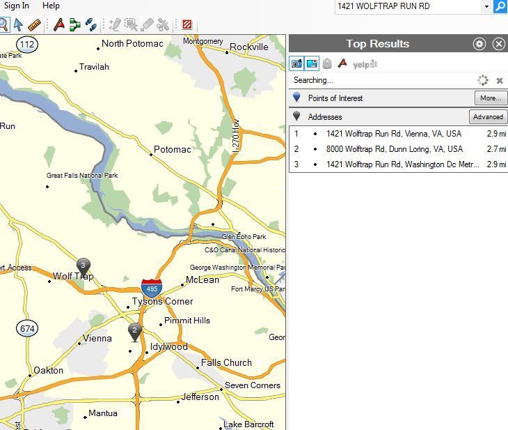

    While the address input doesn't yet work properly you can at least do what you suggest without bringing up the full address entry page, which of course is the same with MapSource. Enter the postcode into the search filed top right and hit the search button. That works for UK maps, and from a quick test appears to work for US maps when you enter the zip code.
    I have MapSource 6.16.3 and there is no Search Field anywhere on the screen, certainly not "top right".
    I have gone thru all the menus trying to find a way to pop it up there to no avail.
    Find Places is the only Search Method that I can find to use. and if you enter only a zipcode, it says "No Items Found".
    what it should do is take you to that zipcode area of the map.
  • You misunderstand me. I was saying that MapSource has a similar address entry page to BaseCamp, not that MapSource has a simple search field. It's BaseCamp that does and will do what you want. Also if you know the address you can enter that in the search box top right also, see here
    Note when you do and hit enter the side panel pops out, you don't need to manually display it first. You can then select from the choices it gives you.
