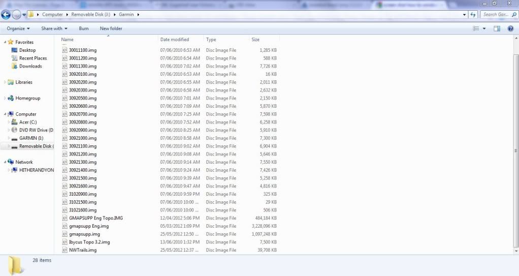

I have used Basecamp to download two different map sets (NW topo and NW trails) to the 450. Both download OK and both are named, by Basecamp, gmapsupp so they overwrite one another. When I change the name (I am opening up the SD card on my laptop, opening up the garmin folder and re-naming the file) from gmapsupp to anything else (I've tried gmapsup1, gmapsupp.img, etc., etc.) the file is no longer recognized by the 450. It appears as if I can only have one map file downloaded from basecamp. I have other .img files on my SD card (i.e. ibycus topo 3.2.img, gmapsupp Eng) these show up nicely and these allow me to change the name and still work.

    Eliminating the space in the map name did not help. The only way that I can get my 450 to recognize a BaseCamp downloaded map is to rename it mapsupp.
    After downloading two map files, I can rename and place one mapsupp file on the unit's internal memory and then rename the other one mapsupp leaving it on the SD card and, in this way, I have two different map files that the 450 recognizes. But, with this workaround, I'm limited to two map sets downloaded from BaseCamp - only one of which can be a large file.

    First turn on visibility of extension in Windows. I'm sure you can figure this out by using Google...
    Second, post a screenshot of the file folder with the maps in it.
