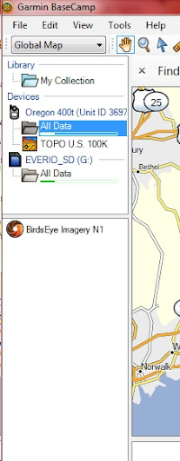

    When you does the All Data folder on your Oregon ever show the yellow circle with the down arrow or the green circle with the check mark? I'm trying to narrow down if BaseCamp doesn't think there is data to transfer or if there's a problem with the sending.
  • Former Member
    0 Former Member
    It show neither, it always shows a short green bar, when I mouse over the line it says " Transfering User Data " but nothing transfers. It always has the green bar on the "All Data" under Garmin and the "All Data" for the memory card even if I am not sending data to it. See attached pic

    UPDATE:
    okay, after I sent the last message, Basecamp did an automatic update and the program restarted. The green bars went away so I tried to send the Birdseye image to my Garmin and then the folder had a yellow circle with a down arrow and the files transfered. :D
    I am not sure if it had anything to do with the update but I am just glad it works now.
