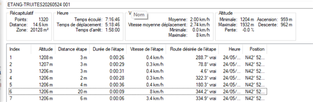

See under a sample:
mean speed : 2.61km/h
duration : 6h16mn
2,61km/h ×(6+1÷4+1÷60)h = 16km36
but the sum of slope distance = 14km78
and the horizontal distance = 14km56
14km78 vs 16km36
from gpx file :
<gpxtrkx:Distance>16360</gpxtrkx:Distance>
<gpxtrkx:TotalElapsedTime>26215</gpxtrkx:TotalElapsedTime>
<gpxtrkx:MovingTime>22586</gpxtrkx:MovingTime>
for Garmin basecamp

  • A saved or sent track contains statistics based on the trip computer and the track log.
    Devices determine a position every second.  The trip computer calculates then distance, direction and elevation between two positions.  The change in position is also the speed in m/s (1 sec interval between positions).  The programing probably uses a threshold value to determine moving or stationary. If moving add 1 to moving time; distance to total distance, elevation change to ascending or descending based on sign.  If stationary, add 1 to stationary time.  The distance value is likely rounded to the nearest meter at the end of the track.
    The track log records positions based on it's own logic or your setting.  I assume you added up the leg distance column to obtain the 14km56, and added the ascending/descending values to obtain 14km78.  If you did this, you included distances recorded for stationary movement that were rejected by the trip computer.  You also suffer from rounding errors in each leg distance.
    In basecamp, make a duplicate of this track.  In the properties window select and delete point 6.  This will force a recalculation of the statistics and they will be based on the track log.
    As an aside, adding ascent/descent to horizontal distance does not give total distance.   Climb 10m over 100m horizontal is a distance of ~100.5m not 110m.  Climb 100m over 100m horizontal is ~141m not 200m.

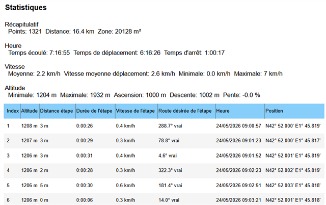

  • In basecamp, make a duplicate of this track.  In the properties window select and delete point 6.  This will force a recalculation of the statistics and they will be based on the track log.
    you're  right, the statistics are ok now
    and it's the horizontal distance : 14km56 rounded to 14km6
    btw, if I delete a non-zero distance, the result is the same, it's just a way to ask Bascamp to recompute stats

  • The track log recorded 1320 points.  The trip computer used over 26,000 points (it determines a position in 1 second intervals).
    GNSS does not give a true position.  The direction and magnitude of error varies.  The more points collected the greater the cumulative error.
    Determining motion at a 1 second interval can be done simply by looking at the distance between adjacent points.  In the track log it is easier to use speed..  The first 5 points in the data you provided indicate 16m of movement.  According to the internet, turtles walk around 0.8 to 1.6 km/h.  If I assume your friend is faster than a turtle, the speed column suggests that your friend was stationary and that 16m should not be included in total distance.
    If one were to collect data while walking a perfectly straight line, all of the collected points would not fall on that line. The distance based on all of the points would differ from that using just the first and last point.
