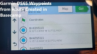

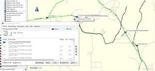

The Garmin GPS DriveSmart 65 does not have offroad map routes, so I upload routes or tracks to it that I've created in Basecamp.
Should I upload a created route for "Offroad" or "Direct" for the GPS to best track and even give turn-by-turn directions on the GPS?
I think the GPS only accepts a max number of shaping points, and when I do Direct, the Garmin GPS, when it reaches the shaping point limit, just provides a straight line route to the end.
The GPS only has a calculation mode of "Faster Time", "Off-Road", or "Shorter Distance".
So is "Offroad" the best route type to create in Basecamp and then use the GPS calculation mode of "Offroad"?
