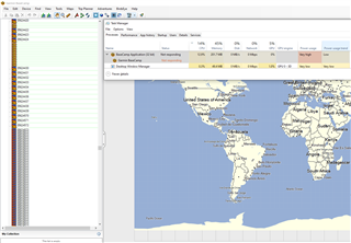

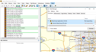

Ryzen 3400G w/onboard graphics, Windows 10, BC 4.7.4.  Upon launching BC, my library box starts to fill up with lots of numbered entries I'm not familiar with and the program becomes unresponsive.  I get so many entries that the vertical scroll bar becomes quite small.  The entry numbers eventually change to midwest city names. Then, BC locks up and "not responding" in task manager.  I've let it sit for over a half hour.  I tried both 2D and 3D shortcuts, uninstalling and reinstalling with same result.  I've never used BC before so this is the first attempt.  I have a brand new Rino 750 connected but see no indication that BC recognizes it before locking up.  I tried BC without Rino connected with same result.  Can anyone provide some insight or troubleshooting tips?

  • A few thoughts: the icons shown in your image of the Device panel seem to indicate they are small sections of a large Garmin US IMG map and BaseCamp is attempting to read them for the first time off your device. Please would you let us know what IMG mapping is on the device and/or the mSD card (if in use), where it came from and how old it is?
    I believe BaseCamp caches copies of IMG mapping to your hard drive since it is quicker to render the map than reading it off the device/card. So I am wondering if BC is trying to cache the mapping and because the device USB port is very slow, you may be interrupting that process before it is fully completed, since this might take longer than 30 mins. I would try first  clearing the BaseCamp cache by pressing Ctrl-G twice. Then reattach your device and leave it for at least few hours to see if it completes the file copying and consolidates the map. Then tell us what is displayed in the device panel.

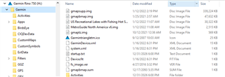

  • Eyelet99,
    My thoughts exactly.  I will delete anything related to Garmin on the Ryzen Machine, reboot, reinstall BC, do the double CNTL-G thing before BC has a chance to lockup, exit BC, reboot, and then see if BC will load and play nice without ever seeing my Rino.  My Rino has some Garmin Fishing hotspots and Garmin Metroguide (detroit area only) loaded on it as well that isn't showing up on the old laptop.  I've confirmed the GmapTool file, the Fishing hotspots, and the Metroguide maps are on the rino.  I'm now wondering if somehow the BC application was finding segments related to my Garmin Bluechart files that were associated with my GPSMAP 740s.  That bluechart covered the entire US I think.
    I'll snoop around with those java tools you turned my on to.  I hope it doesn't write anything to the Rino without implicit instructions to do so.
    If I find anything that could give us a clue of what is going on, I'll post it.  The following image is my Ryzen Machine via Windows Explorer as of now.  The old laptop BC isn't showing anything related to those other img files (other than gmapbmap.img).
