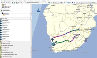

I imported the waypoints and routes from mapsource into Basecamp.
Even if I only select the routes, it does not do it.

    I have used the top menu "Device" to send either the whole gdb or selection to the device. No joy. Only waypoints arrive.
    I have also selected the items in the bottom left pane and sent it to the device and device internal storage in separate occasions. I have selected just the routes and sent them the same way. I have selected the routes one by one and sent them the same way. No joy.

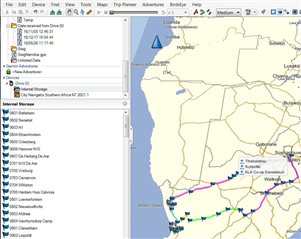

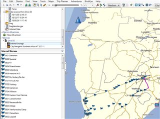

    If I reboot the GPS and select internal storage on Basecamp it shows only one old existing route on the GPS as well as the new waypoints.
    Then I select the list on the top left pane I want to import. I then select the routes on the bottom left pane, right click, and sent them to the GPS internal storage. If I then select the GPS internal storage on the top left pane, the routes show.
    but if I reboot the GPS, the routes are gone again, as in the first picture.
