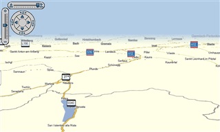

    Hi Robert, thanks for your reply. I changed the perspective, but the problem is I don't see the DEM data at all (everything is flat). This in the below screenshot should be part of the Alps, but there are no mountains at all. On the device from which this map was installed on the PC however, the mountains are visible.
  • Possibly the problem is that BaseCamp can only display one map at a time.  If the DEM data isn't included in the map data, but is in a separate 'map', then you won't see it.

    0 Former Member over 5 years ago in reply to SUSSAMB
    Good point. I suspect the gmapdem.img is used for elevation.
    But on the other hand, the elevation is visible when the Zumo is connected (so when there are supposedly 2 maps used, the gmapsupp and the gmapdem).
    Considering there can only be one map visible at a time, the elevation should be visible on the map installed on PC, but it is not, it is actually visible only with the Zumo connected to the PC.
  • I don't have a Zumo, so this is supposition but you mention gmapsupp and gmapdem. The main map is gmapprom.img, gmapsupp.img is a supplemental map. The EU map as it's over 4gb is split into North and South as you mentioned. So it could be that gmapprom.img is the North map and includes DEM data but the South map, gmapsupp.img, has a separate DEM map
  • Former Member
    Good explanation, this is probably the cause. I however do not understand why the elevation data is not included in the map installed on PC.
