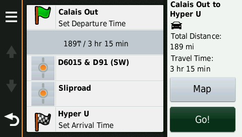

  • Shouldn't be that way, what makes you think they are now actually shaping/do not alert points? If it has worked you should see something like this in trip planner, the orange circles are shaping points and do not alert:

    The only thing that makes me thing that is that the route is no longer broken up into 3 routes on the Nav V when I push it over there. Oddly, in the BaseCamp route detail dialog, the route Summary box still lists 78 Via Points! So, this makes no sense to me at all.
    When I look at the route on the Nav V, I have a very similar image, except the little circles are light blue, not orange.
