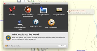

For some reason Basecamp will not see my F5X+ although Express and Android File Transfer can see it - anyone else using it on Catalina, is it working for you? Anyone had this issue before where basecamp not sees the MTP device?

I tried that, and closing all express related stuff - BC just sits there seeing no watch.

Yep - whatever I do BC just sits there
4.8.4 v by the way on Catalina
