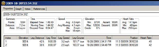

    When you double click a track a new window opens with a Properties tab. Grab the right side of that window and drag it way right to see all the categories available. Then put the cursor on the gray category area, right click, reset headers to show any categories that were hidden. Those are the only data types available in BaseCamp.
    I'm using Win7 and the top Summary box for speed has Avg Moving Speed based on only the Moving Time. Stop Time is removed.
    You can select and highlight any portion of the data and the Summary Boxes will all update showing data for only the selected area. Also the track will be highlighted showing what you have selected.

    BaseCamp will only show data in the Summary boxes that your 64 has recorded.
    If you reset the headers by right clicking the gray category strip you will see all the data categories that are available but not necessarily used by your 64.
    You wrote " When I go to view the data on Basecamp later I see : Total distance, Area, total elapsed time, average speed, ascent descent, max elevation, min elevation." There should also be more data unless you are saving your tracks to your 64 using the 64 menu. See the attached JPG screenshot showing the categories you should have data for.
    Some of the older 64's truncated the data when using that save option. Can you attach a copy of your track and I will open it on my machine and see if the rest of your data is there.ciq.forums.garmin.com/.../1273270.jpg
