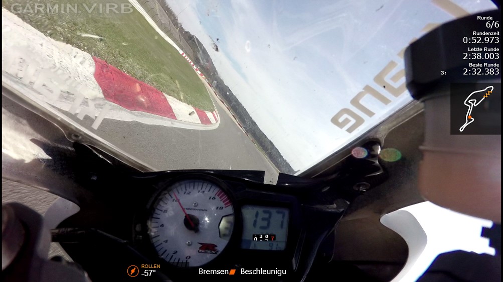

  • OK, I think I finally got it...
    Take all your footage and create a new video. Don´t cut anything!!!
    Select G-Metrix then Data-Tab.
    Now Activity Starttime and manually forward to your first pass of the finishline. The real finishline, not the same height from paddock/pitlane perspective.
    You will loose the fist lap, off course. But due to the fact, you came from pitlane, it does´n really matter.
    You have to do that only once, and only for the first recording!
    You can export the recordings now. Then reimport the result and start cutting your suff as you want.
    Disadvantages:
    • Exporting the whole stuff takes time and space.
    • First and probably last lap is missing
    • Finishline is along the track, not across (sometimes)
    • Laps, best time, best lap, etc. start new for every recording
    The most important thing is, not to cut anything! Only change starttime, add your gauges and export.
