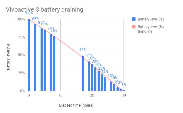

    After using the Web Updater, and making a factory defaults reset, nothing changed. I logged the battery drainage, it's shown on the picture as a chart. The device completely depleted from 100% to 0% in 30 hours, with minimalist usage and all battery saving possibilites set.
    ciq.forums.garmin.com/.../1373848.png
