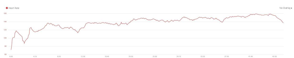

There is another topic regarding an upgrade to sensor version 5.8.
I took this upgrade today via Garmin Express.
Later on I did an indoor cycling workout with the Garmin ANT+ speed sensor and using on board HR.
For the first time I did a workout (33 minutes ling) without any dropouts.
For those with this ANT+/HR dropout issue, please take the upgrade and report back.
Hopefully you can have a workout that looks as clean as mine.
ciq.forums.garmin.com/.../1318902.png

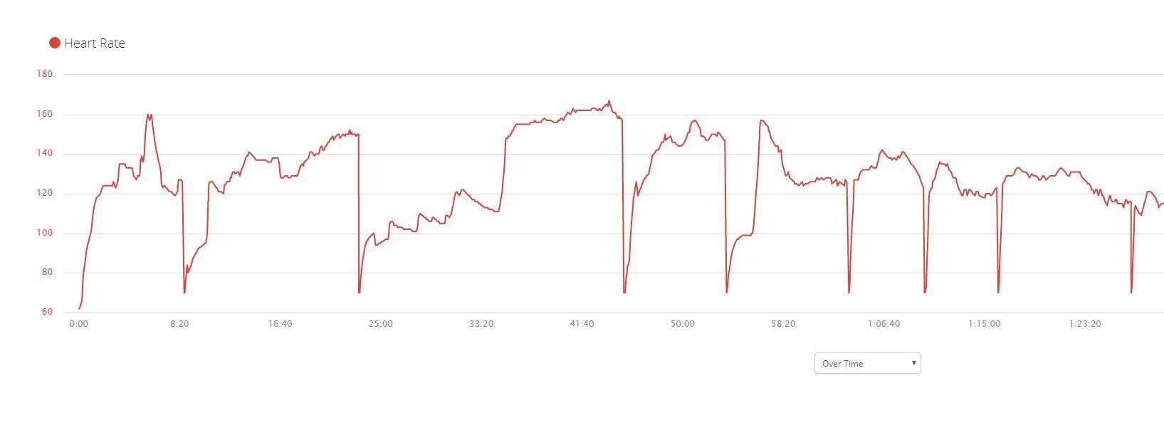

  • Just adding my voice to the disgruntled ..............
    Having similar issues with my VA3, It all seems to be working just fine and then the HR reading drops to 70 and takes anything from a few seconds to a few minutes to return to normal.
    I have a Mio Fuse with oHR sensor and it has never missed a beat in the years that I have had it paired with either my phone (Samsung S-Health) or my Oregon 750.
    When the VA3 is working the readings between the two units is just one or two bpm.
    I decided to switch to the Garmin as my step count, HR data and tracklogs were all in different apps and devices and I wanted an all in one solution.
    For the most part I am very happy with the VA3,hope that they get the issue sorted soon.
