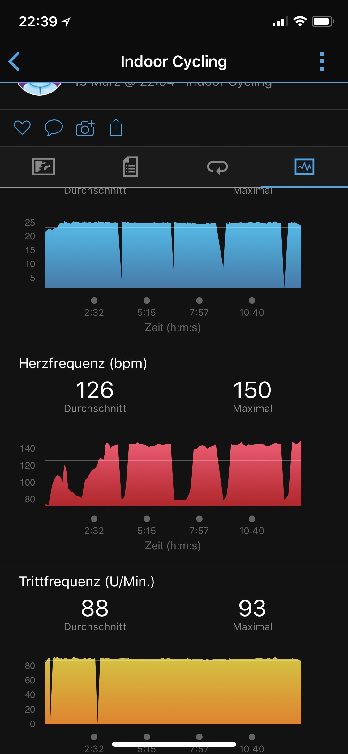

  • Any sensor dropout improvements with software 3.40? Assuming no, but maybe an undocumented fix. I haven't been able to ride and test due to weather. Probably going to be a sensor hub update anyways.
  • Former Member
    0 Former Member over 7 years ago
    Still getting drop outs with 3.40 and 5.80ciq.forums.garmin.com/.../1321352.png

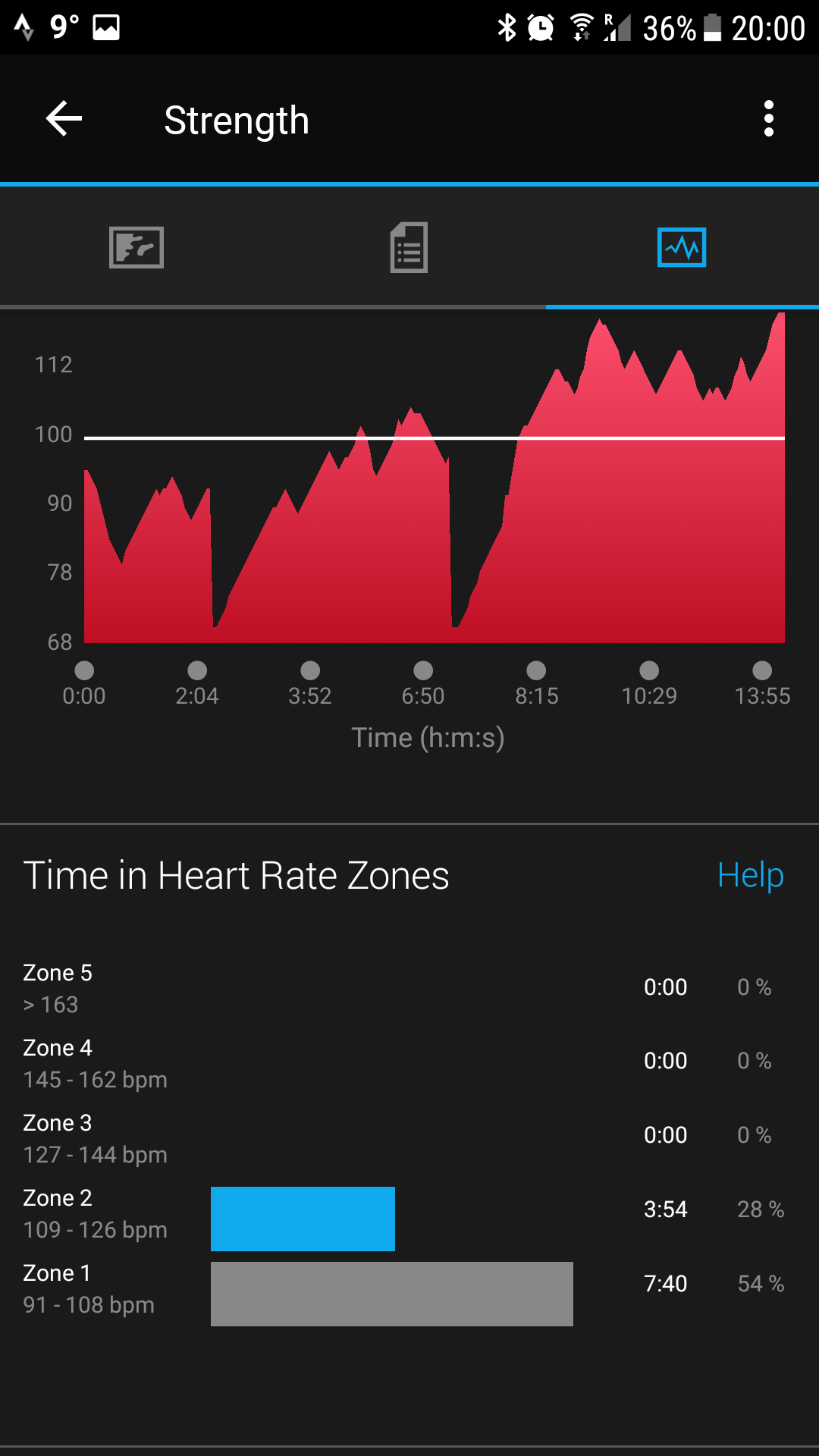

    That HR dropout is exactly what I'm getting with my VA3 with onboard HR though I'm not using any Ant+ sensors

    The same here too...on everey 15 minute ride at least one dropout of cadence- and/or speedsensor. OHRM drops too. I got this to measure my rides and it doesn‘t really work. I even got some extra garmin branded sensors for my bike, thought that‘ll help.
    If Garmin can‘t make it work properly why don‘t they find a way to interpolate the measured values so they would at least get close to reality? I know others can do so...ciq.forums.garmin.com/.../1324336.jpg
