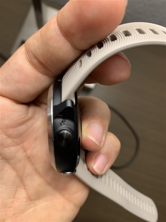

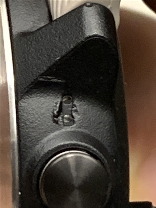

  • I have noticed that there are cracks on my 645 non music. Where the strap attaches to the watch.
    Sent some pics to Garmin and they offered to RMA it. Bear in mind my unit was purchased in April 2018.
    I have had a number of issues with Garmin products and every time they have gone above and beyond my expectations.  There aren't many companies that give such good service outside of warranty periods.

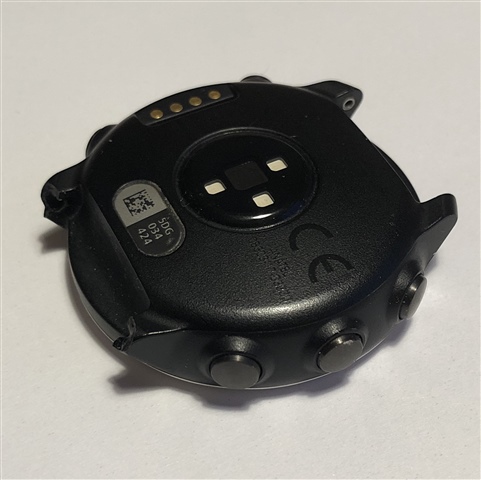

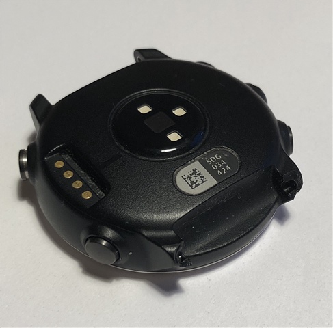

    This morning prepping for my race my watch band fastener fell of, snapped at the corner. Lucky me I had a spare band laying somewhere in a drawer. While changing the watch band I noticed on the bottom side that both lugs started to crack. It’s still in early stages but noticeable.
    Tonight I will contact Garmin Netherlands by email with some photos and linking also to this thread. Hopefully they will exchange it. Otherwise I may consider an other brand.
    crack bottom side
    crack upper side
  • Now this have happened to my unit. Both metal inserts in the lugs where the pin for one side of the wristband attaches broke off.
    It seems like a manufacturing flaw, if the material is likely to fatigue they should have been better reinforced.
  • Former Member
    0 Former Member over 5 years ago in reply to JOBERO76
    Oh my that looks really bad, I have cracks exactly at the same points.
    I hope Garmin is going to acknowledge this problem soon and offers some kind of replacement program like Apple does. The cases are piling in now.
