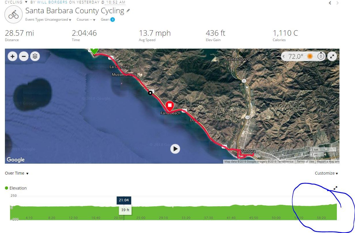

    Mike, Thanks for the help here. Still isn't working as expected. Looks like it now cuts at the halfway point. Basically what we did was rode to lunch, paused the activity, then started it back up for the ride home. somehow 50 hours got entered in between those events and I just need to remove the junk from the middle. it should read 2:04:35 of data. with your file it reads the correct summary, just not the HR, Cad, Speed, elevation, etc. Any chance of recovering the second half of the ride? again, i wouldn't care so much except TP needs this to calc my TSS and load. I wasn't supposed to do this ride but it was mandated by the wife, so I need to fess up to the coach with accurate data. He's buried me this week with training so I want all the credit for what I've done.

    Will_Borgers - there is 2hrs39min25mins worth of data in the file. I can trim junk out from the middle but I need to exactly where as my idea of what might be junk might not be the junk you're thinking of.
    Have a look at this file.

    Mike, you are the absolute man! This file worked perfectly! Thank you so much for straightening this out for me! How exactly are you able to get into the file and work on it? I've been using the garmin devices almost a year now and have had to through away 4-5 files because of this junk. I'm a total noob at diving deeper into the data than Garmin Connect or TP.
