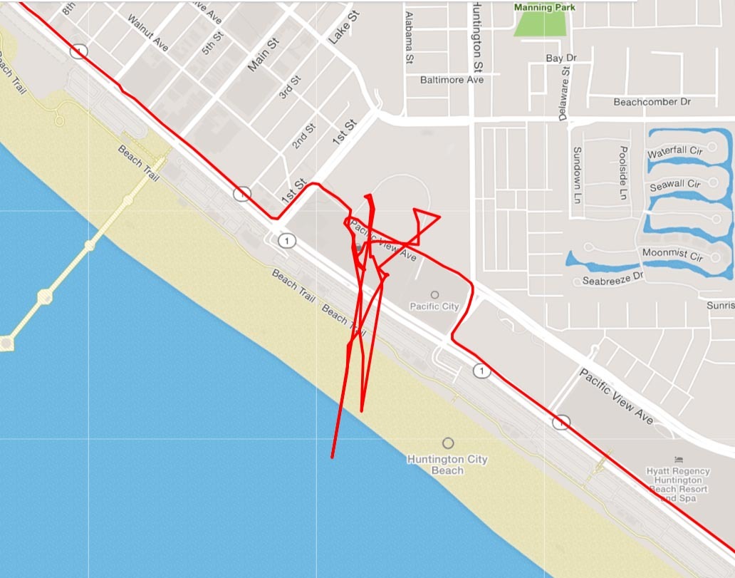

  • In addition to my earlier post to this thread (see below), I experienced a full power-off shutdown with a really weird navigation track while stopped for 5 minutes on a street to make a phone call (screenshot attached). I never had any of these problems prior to v5.0. I've downgraded to v3.9 and things seem to be functioning normally again... I hope.
