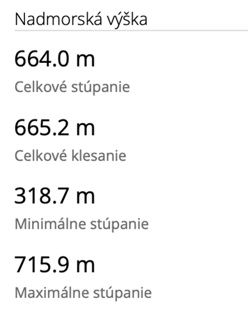

    As I have written here on the forum many times, most of my activities have different ascended and descended metres for each activity.
    Also today, a 14km run from point A back to point A, the difference in gained height was 18 meters. I calibrated the watch twice before the start using GPS... I thought until now that it was because of the cold thats affects the barometer, but today it was quite warm and the difference between the gained heights  is huge. There is something wrong with the barometer in the watch and I can't do anything about it. Here on the forum, no one from Garmin will respond to your problem.
    data from watch    data after corections from garmin connect
    left, data from watch, right data after corections on garmin connect web...
    first number is ascent, second descent
