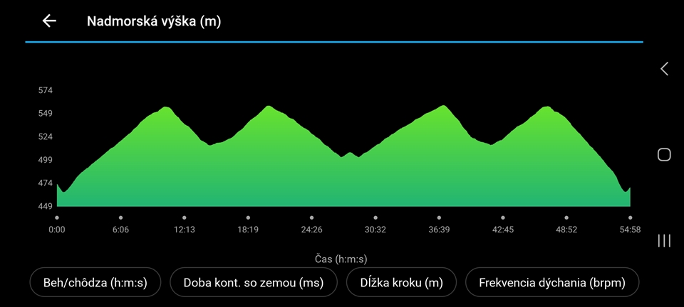

  • I have the altimeter sensor mode set to "Automatic". In the shooting mode options, the option "Automatic", "Altimeter only" or "Barometer only" Why do you think that altimeters are only measured with a barometer? Below is a picture from my run today. the run was out and back and the altitude meters of the start and end run are identical.

    Look at your ascended and descended height meters if you have the same numbers after each activity

  • The difference between the total ascent and descent is a maximum of 6m, which I observed in about 15 of my runs. But I am a special case, because I live in a block of flats with two entrances and they are not at the same altitude. But I will watch it.
