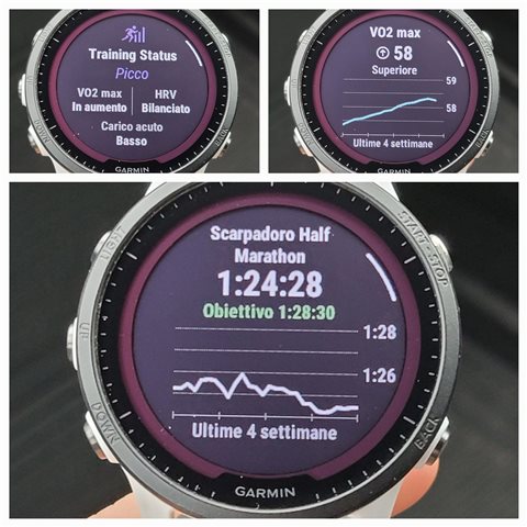

  • Done half marathon 4 days ago in 1:26:52, so race predictor is quite good
    VO2max went from 57 to nearly 59 today in 5 weeks
