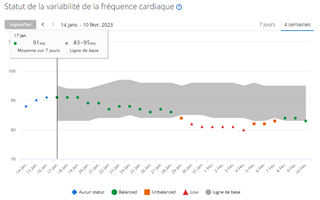

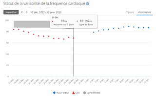

  • Hello, I also experienced an important decrease of my HRV after a software update end of 2022, without any baseline adjustments, it was getting unbalanced. So I decided to reset the watch beginning of the year and 3 weeks later, everything seems fine again. Not ideal.... But just to share.
  • Reset as in a full factory reset?

  • You mean you did a factory reset and your HRV baseline was not reset ? not what I exeperienced. It took about 3 weeks to rebuild the baseline, but at least was it consistent with HRV measures and training intensity.
