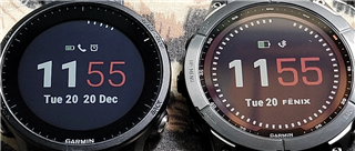

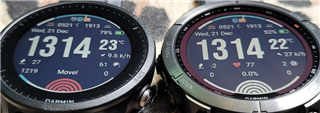

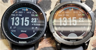

  • New video comparing FR955 screen to F7 solar screen side by side.
    https://youtu.be/2kDrvpweYOI
    Reflective difference:
    From the angle below there is no reflex problem.
    But can still see the difference in the black background being more red toned in the solar.

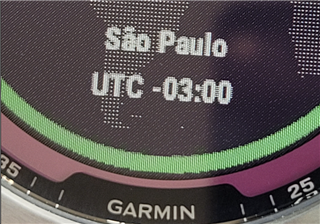

    With a zoomed photo is possible to see the tiny dots amongst pixels in the solar MIP screen. This is not the case in the regular screen.
    I believe Garmin included these seems to be small solar light absorbing cell in the middle of the pixels to be able to say the new generation has more solar capacity than previous one. But this was at the cost of screen sharpness in already very low resolution screen. Complete nonsense!
