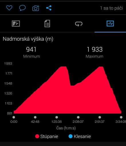

  • I have the same problem with altitude accuracy...last time i was skitouring was beautiful, stable and sunny weather 2 days in row.

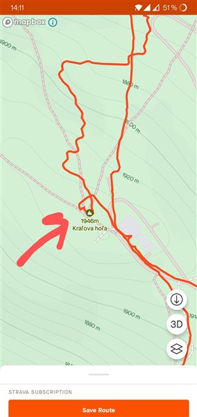

    The altitude on the peak table was 1946 masl. and 955 was 1933 baro and similar on gps...i was there 15 min. and nothing changed. Im using all gps + multi and 1sec. During the trip were altitudes /gps+baro/ many times the same, but on peak were both wrong. And its peak with open sky. The same problem i noticed on trips before, peak 1477 masl.  and my 955 was 1470. My 8 years old Suunto Ambit2 is only 1-2 meters away !!! its software or hw problem ? look at the attached images.
     1933 on FR955

  • I have calibrated the watch sometimes...but, the calibration is still based on gps signal. When you start your activity, the watch is searching for gps and  few minutes  after gps fix, the barometric altitude is "the same" as gps altitude - called Fused Alti on my old Suunto Ambit2. But, i dont kow if it works, bcs its it not possible that the gps altitude is wrong too...and the fix with water ? :D should i go swim before any activity fot 20min ? Smiley
