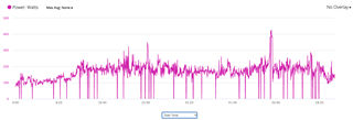

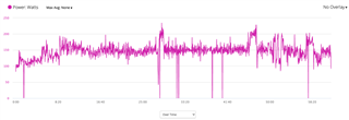

  • Still suffering from drop outs via ANT+ on my 945. This is more so the case with 945. I have a 1030 head unit as well and tested with a lot less drop outs (see pics below). I have tried repositioning the 945 closer to trainer with no change. Earlier recommendation with regard to changing channels on house modem I havent tried, more for fear of breaking something. I have also tried connecting the 945 via Bluetooth. It initially connects to bluetooth fine but then wont stay connected. My understanding is this is the prefered connection method?? Any thoughts/suggestion would be greatly appreciated?!
